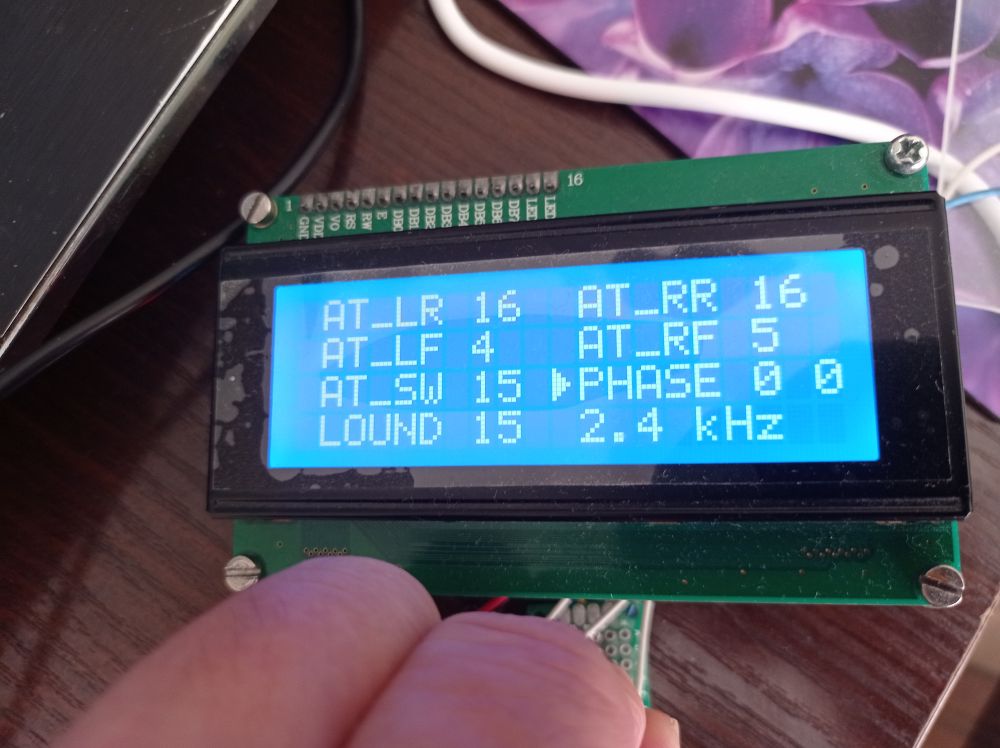

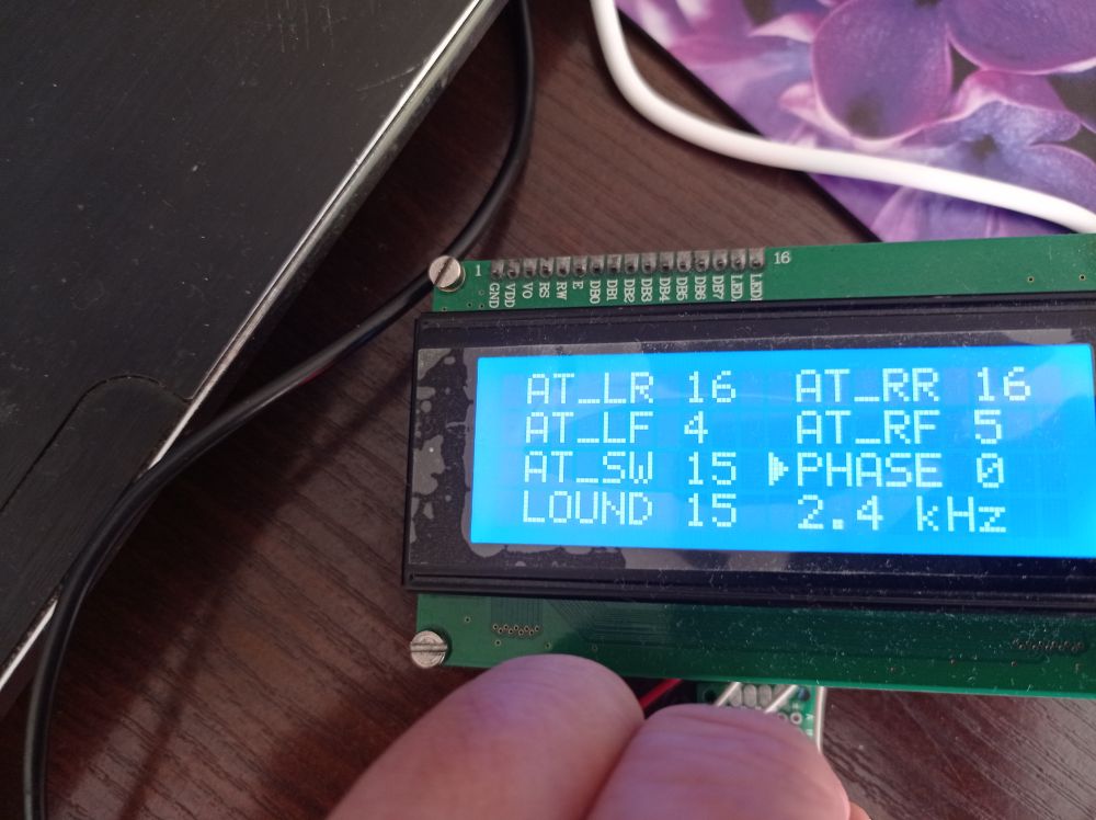

При регулировке фазы ничего не происходит , все время светится 0.http://forum.rcl-radio.ru/uploads/images/2026/06/dff7f9917ff474e43282df86c0d4021b.jpg

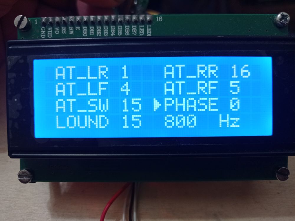

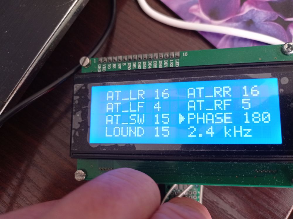

Попробуйте при регулировке фазы сабвуфера покрутить энкодер как влево ,так и вправо.

      case 1: lcd.print("1.25");break;
      case 2: lcd.print("1.5 ");break;
      case 3: lcd.print("2.0 ");break;}
  lcd.setCursor(11,2);lcd.print("MQ ");
    switch(mid_q){
      case 0: lcd.print("0.5 ");break;
      case 1: lcd.print("0.75");break;
      case 2: lcd.print("1.0 ");break;
      case 3: lcd.print("1.25");break;}
 } // menu0 = 2
////////////////////////// GAIN IN /////////////////////////////////////////////////////////////////////////////////////
if(in_x==1){ menu0=100;
   switch(in){
     case 0: gain0 = gain1;break;
     case 1: gain0 = gain2;break;
     case 2: gain0 = gain3;break;
     case 3: gain0 = gain4;break;
     case 4: gain0 = gain5;break;
     case 5: gain0 = gain6;break;
     if(ir.value==IR_3){gain0++;gr1=1;gr2=0;cl1();time0=millis();times1=millis();zast=0;www=1;w=1;gain_func();}// кнопка >
     if(ir.value==0xFFFFFFFF and gr1==1){gain0++;gr2=0;cl1();time0=millis();times1=millis();zast=0;www=1;w=1;gain_func();}// кнопка >>>>>>
     if(ir.value==IR_4){gain0--;gr1=0;gr2=1;cl1();time0=millis();times1=millis();zast=0;www=1;w=1;gain_func();}// кнопка <
     if(ir.value==0xFFFFFFFF and gr2==1){gain0--;gr1=0;cl1();time0=millis();times1=millis();zast=0;www=1;w=1;gain_func();}// кнопка <<<<<<
    if (newPosition != oldPosition) {oldPosition = newPosition;if(newPosition>1){newPosition=1;}if(newPosition<-1){newPosition=-1;}
    gain0=gain0+newPosition;myEnc.write(0);newPosition=0;time0=millis();times1=millis();zast=0;www=1;w=1;gain_func();}
   switch(in){
     case 0: gain1 = gain0;break;
     case 1: gain2 = gain0;break;
     case 2: gain3 = gain0;break;
     case 3: gain4 = gain0;break;
     case 4: gain5 = gain0;break;
     case 5: gain6 = gain0;break;
  au();
 lcd.setCursor(7,1);lcd.print("INPUT ");
switch(in){
  case 0: lcd.print("AUX1");break;
  case 1: lcd.print("AUX2");break;
  case 2: lcd.print("AUX3");break;
  case 3: lcd.print("AUX4");break;
  case 4: lcd.print("AUX5");break;
  case 5: lcd.print("AUX6");break;
lcd.setCursor(5,2);lcd.print("GAIN ");lcd.print(gain0);lcd.print(" ");lcd.setCursor(14,2);lcd.print("dB ");
if(in_x==1){in_time=3000;}else{in_time=10000;}
if(millis()-time0>in_time&&w==1&&mute==1&&power==0&&zast==0){if(menu0==1){cl();}w=0;if(menu0!=0){cl();}menu0=0;menu=0;menu1=0;menu2=0;in_x=0;w2_arr();
   EEPROM.update(0,vol+63);EEPROM.update(1,bass+15);EEPROM.update(2,mid+15);EEPROM.update(3,treb+15);
   EEPROM.update(4,att_lr);EEPROM.update(5,att_rr);EEPROM.update(6,att_lf);EEPROM.update(7,att_rf);EEPROM.update(8,att_rl);EEPROM.update(9,att_l);
   EEPROM.update(10,loun);EEPROM.update(11,loun_f);
   EEPROM.update(12,bass_f);EEPROM.update(13,mid_f);EEPROM.update(14,treb_f);EEPROM.update(15,sub_f);
   EEPROM.update(16,bass_q);EEPROM.update(17,mid_q);
   EEPROM.update(18,gain1+15);EEPROM.update(19,gain2+15);EEPROM.update(20,gain3+15);EEPROM.update(21,gain4+15);EEPROM.update(22,gain5+15);EEPROM.update(23,gain6+15);
if(millis()-times1>60000&&zast==0&&mute==1){zast=1;menu0=100;}
if(w==1&&zast==1){cl2();w=0;times1=millis();zast=0;menu0=0;menu=0;menu1=0;menu2=0;in_x=0;w2_arr();}
void gain_func(){if(gain0<-15){gain0=-15;}if(gain0>15){gain0=15;}}
void w2_arr(){w2[0]=1;w2[1]=1;w2[2]=1;w2[3]=1;}
void loun_f_func(){if(loun_f>3){loun_f=3;}if(loun_f<0){loun_f=0;}}
void loun_func(){if(loun<0){loun=0;}if(loun>15){loun=15;}}
void att_lr_func(){if(att_lr>16){att_lr=16;}if(att_lr<0){att_lr=0;}}
void att_rr_func(){if(att_rr>16){att_rr=16;}if(att_rr<0){att_rr=0;}}
void att_lf_func(){if(att_lf>16){att_lf=16;}if(att_lf<0){att_lf=0;}}
void att_rf_func(){if(att_rf>16){att_rf=16;}if(att_rf<0){att_rf=0;}}
void att_rl_func(){if(att_rl>15){att_rl=15;}if(att_rl<0){att_rl=0;}}     //////////////////////////att_sw//////////////
void att_l_func(){if(att_l>1){att_l=0;}if(att_l<0){att_l=1;}}      //////////////////////////phase///////////////
void vol_func(){if(vol<-63){vol=-63;}if(vol>0){vol=0;}}
void treb_func(){if(treb<-15){treb=-15;}if(treb>15){treb=15;}}
void bass_func(){if(bass<-15){bass=-15;}if(bass>15){bass=15;}}
void mid_func(){if(mid<-15){mid=-15;}if(mid>15){mid=15;}}
void cl(){ir.value=0;delay(300);lcd.clear();}
void cl1(){ir.value=0;delay(50);}
void cl2(){ir.value=0;lcd.clear();}
void au(){if(www==1){audio();www=0;}}
void bass_f_func(){if(bass_f>3){bass_f=3;}if(bass_f<0){bass_f=0;}}
void mid_f_func(){if(mid_f>3){mid_f=3;}if(mid_f<0){mid_f=0;}}
void treb_f_func(){if(treb_f>3){treb_f=3;}if(treb_f<0){treb_f=0;}}
void sub_f_func(){if(sub_f>3){sub_f=3;}if(sub_f<0){sub_f=0;}}
void bass_q_func(){if(bass_q>3){bass_q=3;}if(bass_q<0){bass_q=0;}}
void mid_q_func(){if(mid_q>3){mid_q=3;}if(mid_q<0){mid_q=0;}}
void audio(){
tda.setInput(in,1,1,2); // 0...7, 0...1, 0...1, 0...7
tda.setInput_2(0,0,1,1,1,1); // 0...7, 0...1, 0...1, 0...1, 0...1, 0...1
tda.setMix_source(7,0); // 0...7, 0...-31
tda.setMix_cont(1,1,1,1,1,1,1,1); // all 0...1
tda.setMute(mute,0,0,1,0,1,1); // 0...1, 0...1, 0...3, 0...1, 0...1, 0...1, 0...1 mute off = 1
tda.setSoft_1(1,1,1,1,1,1,1,1); //all 0...1
tda.setSoft_2(1,1,1,1,0,3); // 0...1, 0...1, 0...1, 0...1, 0...2, 0...3
tda.setLoudness(-loun,loun_f,1,1); // 0...-15, 0...3, 0...1, 0...1
tda.setVol(gain0,1,1); // -15...+15, 0...1, 0...1
tda.setTreble(treb,treb_f,1); // -15...+15, 0...3, 0...1
tda.setMiddle(mid,mid_q,1); // -15...+15, 0...3, 0...1
tda.setBass(bass,bass_q,1); // -15...+15, 0...3, 0...1
tda.setSMB(sub_f,att_l,mid_f,bass_f,1); // 0...3, 0...1, 0...3, 0...3, 0...1    ///////////phase/////////
tda.setVol_LF(vol-att_lf,1); // 0...-79, 0...1 lov=63+16 att
tda.setVol_RF(vol-att_rf,1); // 0...-79, 0...1
tda.setVol_LR(vol-att_lr,1); // 0...-79, 0...1
tda.setVol_RR(vol-att_rr,1); // 0...-79, 0...1
tda.setVol_SUB_L(vol-att_rl,1); // 0...-79, 0...1             ////////////////////////////////////
tda.setVol_SUB_R(vol-att_rl,1); // 0...-79, 0...1             /////////////////////////////////////
tda.setTest1(0,14,1,1); // 0...1, 0...15, 0...1, 0...1
tda.setTest2(0,1,1,3); // 0...1, 0...1, 0...1, 0...3
306
Re: TDA7313 + DS3231 + IR + LCD2004
Всё отлично. Большое спасибо за помощь
307 (2026-06-20 15:50:05 отредактировано honda473)
Magali2012 пишет:
Тяжело работать  с чужими проектами.Все получилось?Регулировка (по кругу)должна быть как в одну сторону энкодера ,так и в другую. Фото скиньте пожалуйста.
